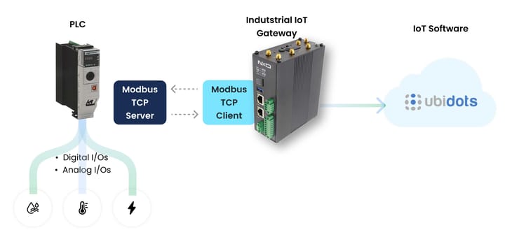

A Quick Tutorial on Rockwell PLC: ControlLogix as Modbus TCP Server
This guide demonstrates how to configure the ControlLogix 5580 L85E PLC as a Modbus TCP server, using the Modbus TCP Server Add-On Instruction (AOI). Follow along to meet your automation needs efficiently while maintaining the highest standards of operation and reliability.
