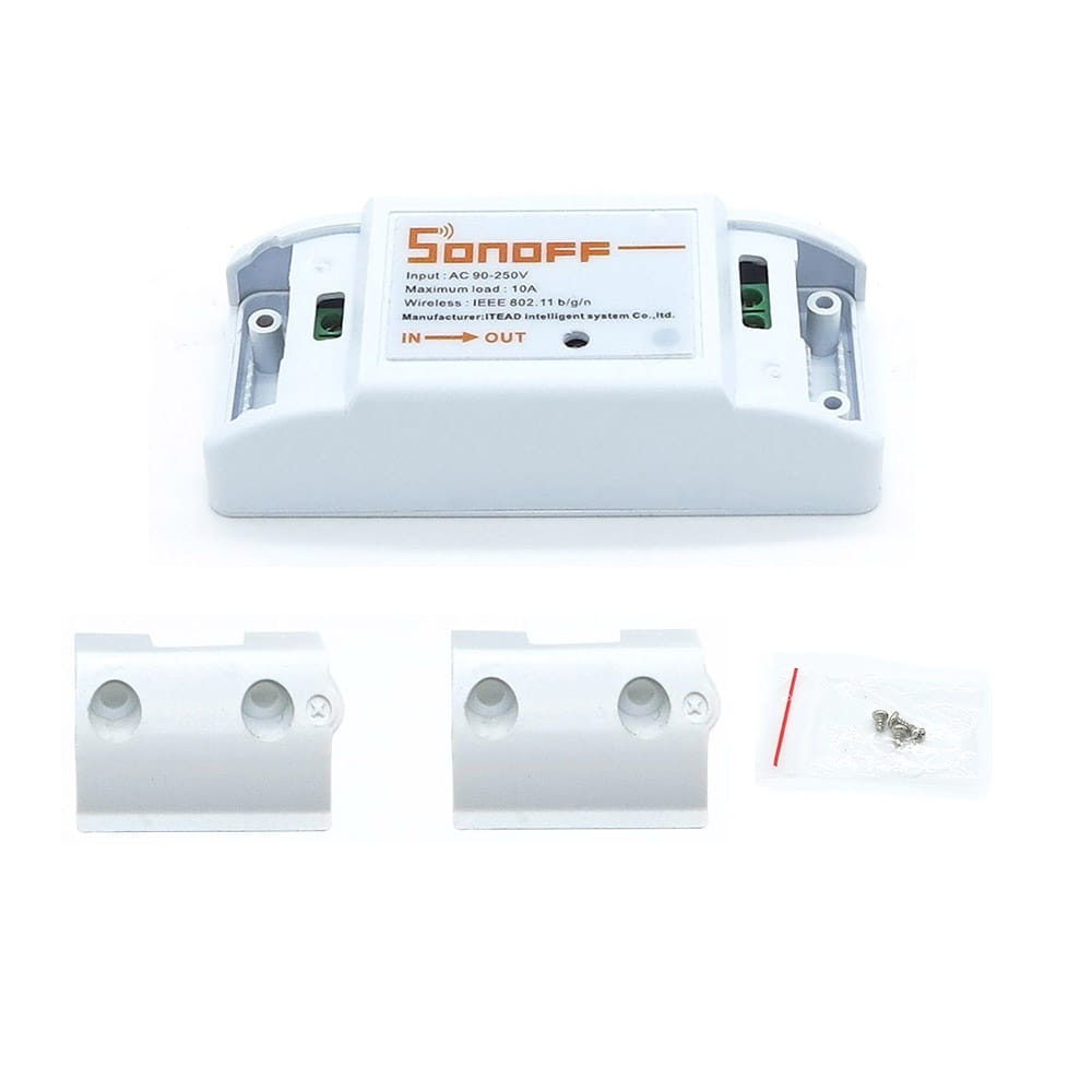

The SONOFF contains a relay, an ESP8266 WiFi chip and the required circuitry to power it with the AC line of a power outlet. It also comes in a nice package that makes it look more professional than an average DIY project at home.

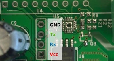

  1. Disassemble the SONOFF device, this is to access the SONOFF TTL pinout, which we’ll need to program the onboard ESP8266. You will need to solder four pins, these are shown in the picture below.
  2. Connect the UARTbee pins to the SONOFF pins, following this pinout:
UARTbee SONOFF
VC CVCC
TX RX
RX TX
GND GND

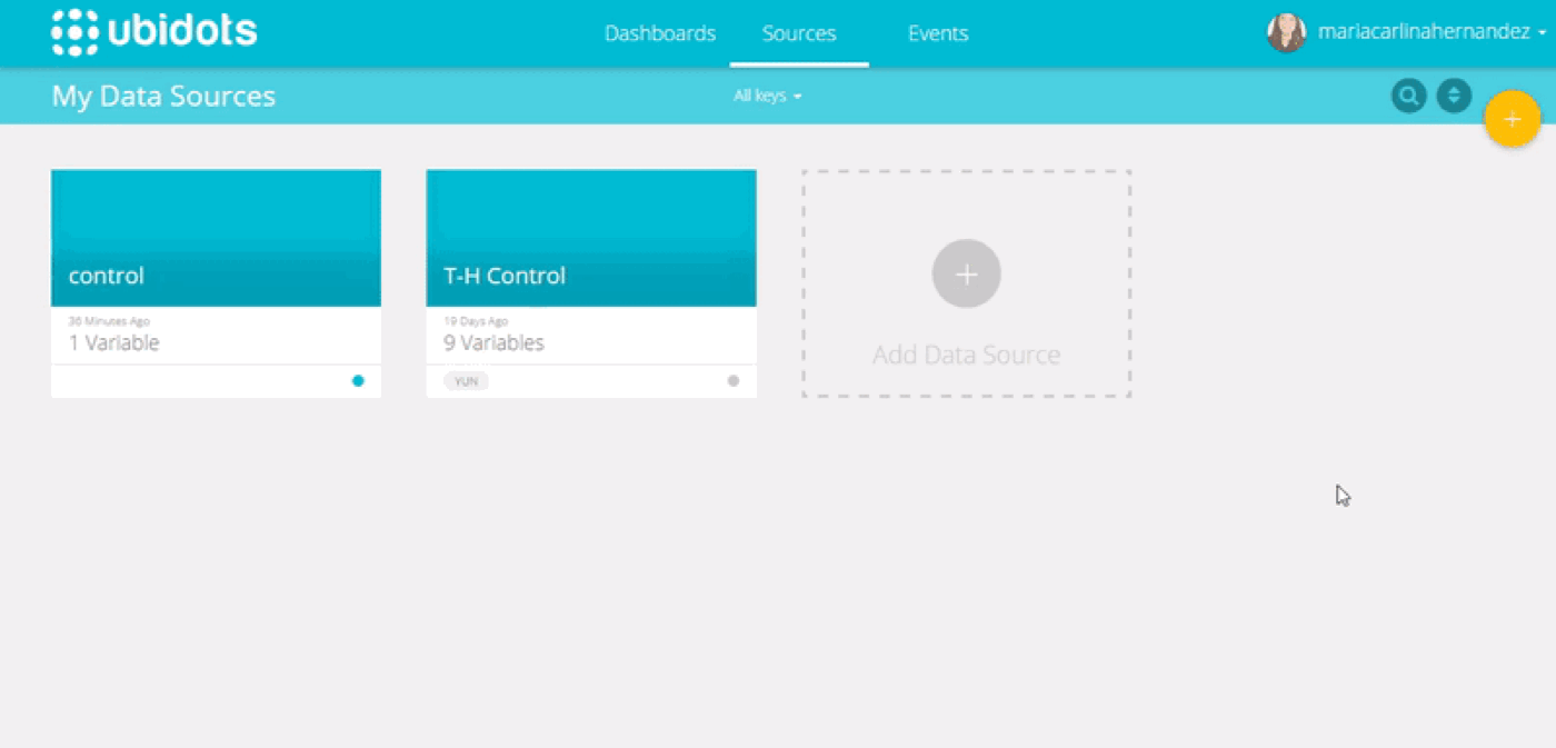

Create a Ubidots Variable
  1. Ubidots account.
  2. Go to Sources and click on the orange plus symbol.
  3. Set the name of the data source and check the label

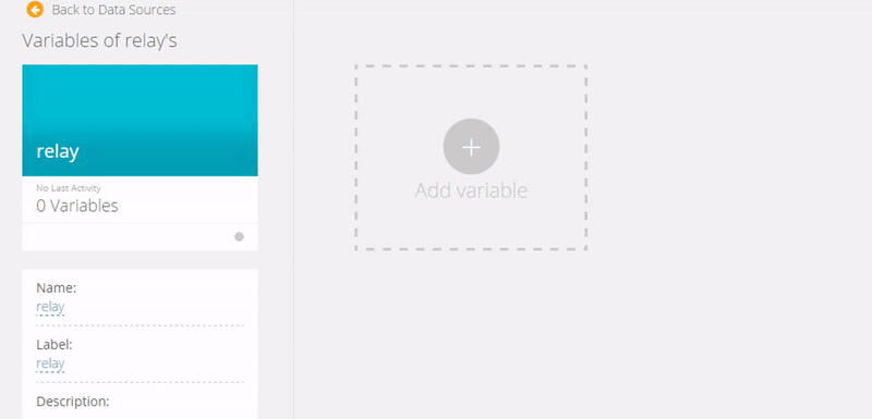

4. Create a new variable for the relay and check the label

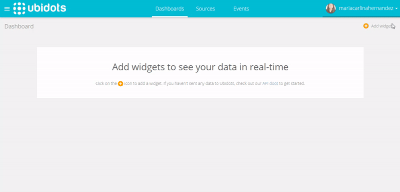

Create a Button Widget
Now, to control the SONOFF device, you will need to create a button widget in you Ubidots account. This widget will set your RELAY variable to either “1” or “0”:
  1. Go to Dashboard and click on the orange plus icon.
  2. Click on Control -> Switchand select the Data source and Variable to control created before.
