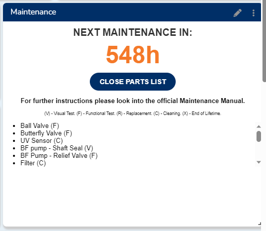

Thanks for the feedback, I actually managed to create a custom HTML widget myself that is more of a countdown. It gets the runtime value and shows when the next maintenance period should be:
ex
And this works fine for me, at least as an initial version. While we’re on the topic of monitoring ON/OFF state, I’ve had feedback from some users that sometimes the dashboard is paused and they haven’t seen it and wonder why the data doesn’t update or the widget doesn’t work as it is supposed to. I want to ask if there’s a way to get the dashboard state and display it in a widget somehow so it’s more clear to see. My guess is it would still have to be a custom HTML & JS implementation, if it’s possible to get the data that is.
