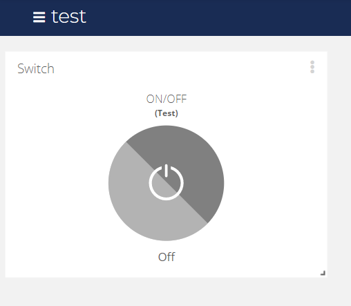

issue is am able to publish data to MQTT Broker. But while i was trying to subscribe i was not able to getting data from MQTT broker Dashboard. i dont know what was the issue.

Dashboard
