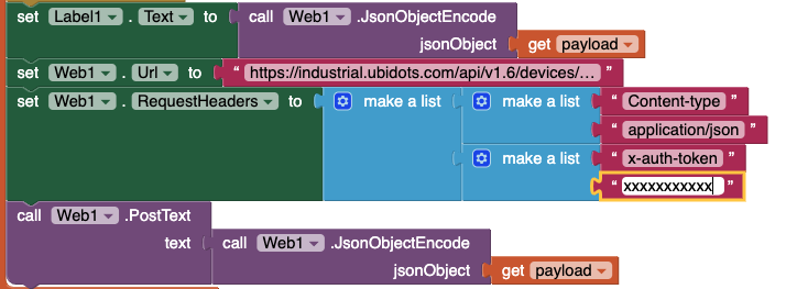

In case it helps, here’s an example I used

Thank you for you reply, i have figured it out
thank you so much it worked for me.
