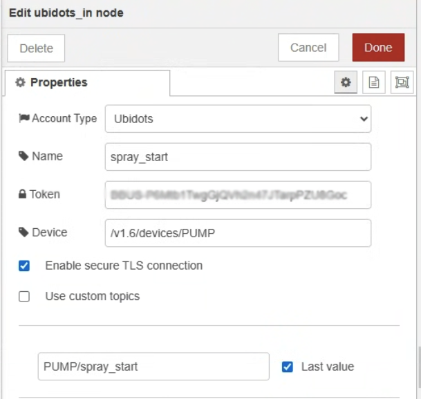

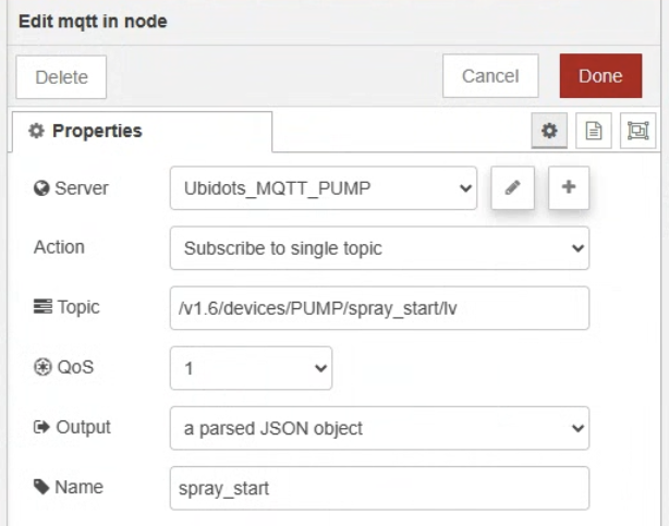

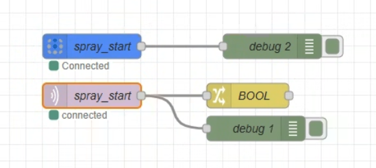

I would like to share my issue on subscribing a ubidots MQTT topic (boolean 1/0 value) from a Node-RED machine. The connection was successfull either by using ubidots_in node or mqtt_in node, however there is no output of the node (check by using debug). I have check that I have put the correct topic, devices and other parameters (like last value, correct path of the device).
Any idea how solve this issue?

Hello @Zulpaedi
I apologize for the issue you are experiencing with your Node-RED connection. The DevOps team has made a change to the MQTT Broker, and I can now see that the subscription is working correctly. Could you please verify this on your end?
